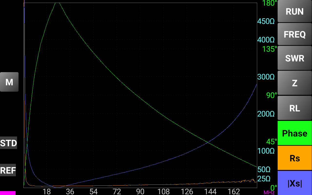

Minivna std
reflection selected then M then XLC toogle, the screen with xtal l and c shown.
Select C it gets yellow, select run it says receiving data, the overlay disappears a graph comes with phase Rs and XS.
screenshot attached...

The overlay must not disappear after a capture, this must be a bug in your particular configuration. Anyway, miniVNA standard is not able to provide the sign of the reactance (Xs) so is not suitable for XLC mode (implemented in BlueVNA), as the resonance frequency is determined by the Xs pass through 0 (with sign change).
