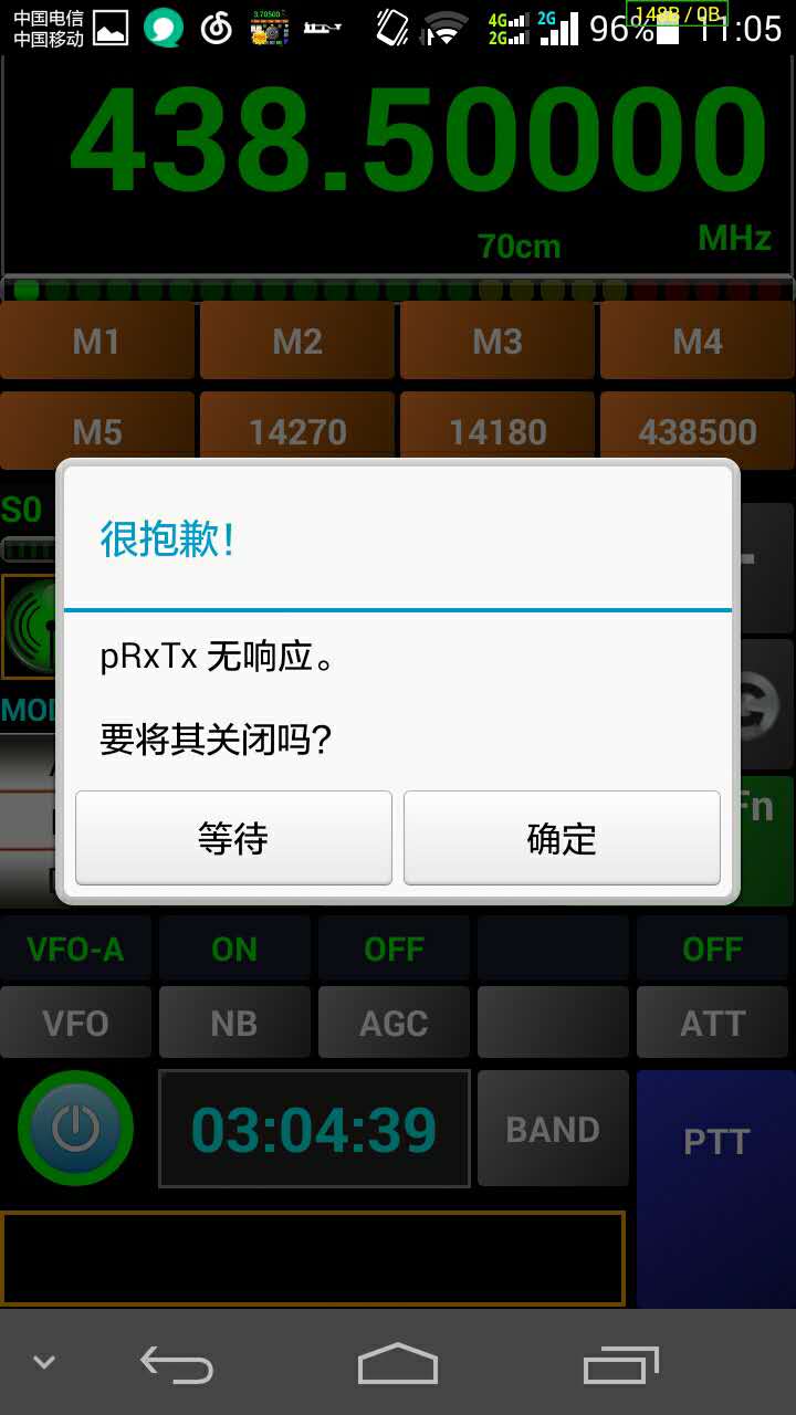

I have updated Pocket RxTx 0.8.1-2, but I found it will hands up and without any response until system notice to shutdown.
attachment pic1 is that after authenticated , my ft-817 is power on but the progrem is hands up
attachemnt pic2 is after a minute, system notice "the program no response" and let me choise : "wait" or "shutdown"
Re: Pocket RxTx 0.8.1-2
If you need direct CAT mode please use Play STore verion (0.8.1-1) till the new version of jAReC will be available.
