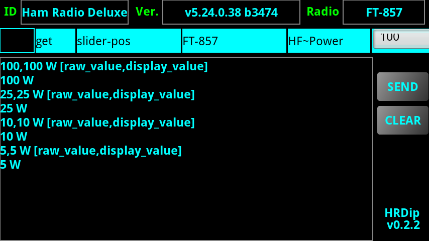

...But the Power is not correct, it's always 5W shown on Pocket TX, indeed it's 100W really on the transceiver.
I have no FT-857 to check something so maybe you can help.
Please install and run HRD ip (updated last Saturday) and play with the commands related to Power:
I need to know the specific values for 5, 10, 25 and 100W (both set and get).
