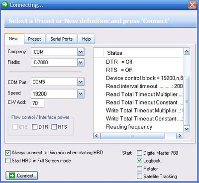

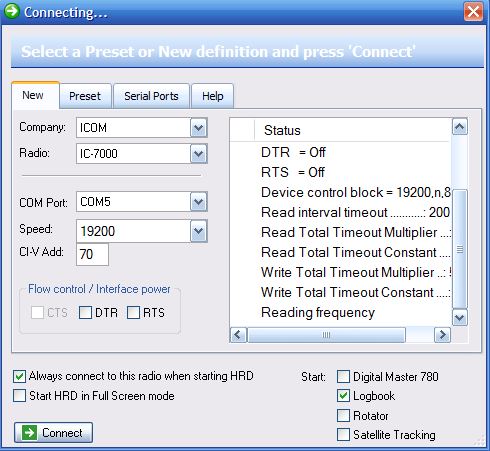

IC7000 address is 70. Don't know if there is a universal address to connect to all Icom TRX. Cant imagine that.
HRD Connect window.

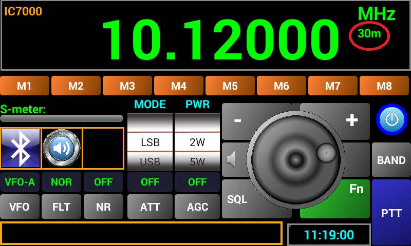

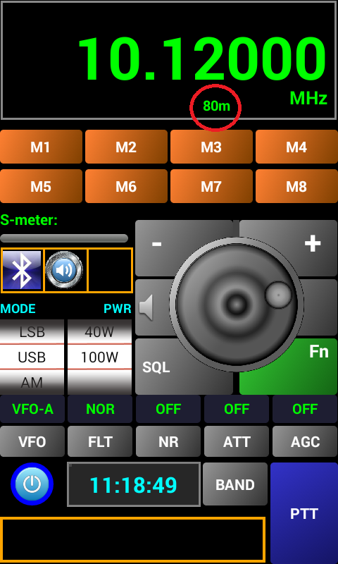

Now working
So here are my findings for the new version:
Some commands work some did not.
In general it looks like a one way connection. That means,
commands transmitted from the mobile will be executed on the TRX,
but there are no response in the app,lets say if you dial the VFO on the radio
the display in the app will not follow the radio.
Functions that work:
Mode selector
VFO A/B switch
NR
AGC
NB
Band
VFO Dial
Functions not working:
S-meter
Power selector
FLT
ATT
SQL
PTT
There are also anomalies in the Frequency display.
I suspect this had to do with the "one way" communication mentioned above.
