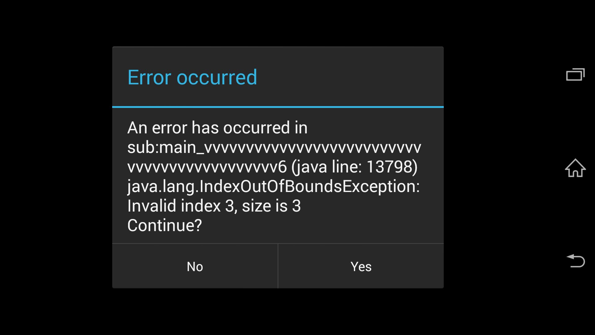

Hi all
When i use the config download i get a error (ft857)

Re: AW: Pocket RxTx v0.8 now available in Play Store
MysticFire wrote:Hi all
http://www.mumble-funk.de - Freier Funk für PC/Android/Iphone
Please try to reset the radios list first. Long press on START button and then select "RADIOS" when in direct CAT mode.
All locally stored radios will be removed and the app automatically connects to the central repository where you will be able to select the radio or config you want to download locally.
Post by MysticFire »
Seems that it is the config. Still have the Error even after the Reset.
Re: Pocket RxTx v0.8 now available in Play Store
I've checked now and I see no issue here. If you load the config for FT817 the error disappear?
You get the same error with both versions of the FT857 config?
MysticFire
Posts: 45
Joined: Thu Jul 02, 2015 6:58 pm
No, only with the downloadable ome. I use this config
