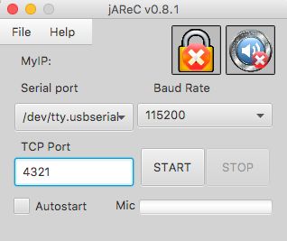

I have tried this evening with a PL2303HX based USB/Serial module.
The following driver was required to be installed on the Mac Mini (Late 2014 with OSX ElCapitan):
http://www.prolific.com.tw/UserFiles/fi ... 151022.zip
After a system restart, the serial interface was available in jAReC.
I think you have a problem with your USB/Serial interface not being recognized by the system.
On which USB/Serial chip is based your interface?
I have tried with a CP2102 too, but I was not able yet to find the right drivers, so it does not work for the moment.
As stated in one of my previous messages, if the serial interface is recognized by the Java subsystem, then if will be visible in jAReC too.
Anyway, it seems to be a bug if running on a Mac: the TCP port and the serial port are not saved in the config file.
I will fix this in the next release.

Hi Konabob,
To better understand, even if is working with FLDIGI, is still unrecognized by jAReC?
Can you please check to see if you have in the system a device like this?
/dev/tty.usbserial

Here is a list I get using the Terminal Utility.
jAReC.jar does not recognize anything in the Serial Ports list.
Is it possible a problem with the 'path'?
