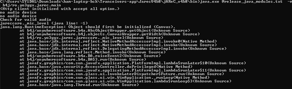

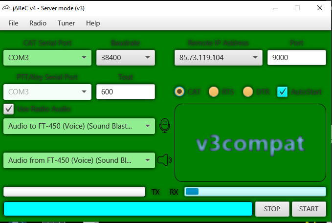

Now to describe an issue which i am not sure if its related to Jarec ....
Having Jarec v4b8 in server mode (v3) compatibilty mode... i open the windows app
(non portable) and it goes yellow color, so it waits for connection.
I open pocketrxtx and connect.... it connects, on windows PC i see message "authenticated" ... and after
couple of seconds.. it shuts down.... and also the mobile app disconnects as well with a message on screen "powering off the radio" . The same happens on the portable version.
So i run the run_debug to see error messages... i have attached image screenshot.
Any ideas Dan ?
https://qrz.com/db/sy1dal
.:: Jimmy Sy1Dal ::.
