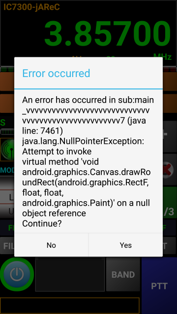

The following error occurs on my mobile phone:
I work with the experimental Pocket RxTx version 0.9.0-19 and jAReC - (j)ava (A)udio and (Re)mote (C)ontrol v0.9.0-17.
If I turn my mobile phone "turn" from the landscape to the following Java error message
java_error2
java_error2
If I use the Pocket RxTx + v08.1-1 does not come this error message !!!
I switch to the version v ... 08xx of websdr on CAT and use thus the same Config.
Even if I use the Jarec v0.9.0-17 version, at least two minutes of a Connect until a LINK BROKEN is listed.
At least I have enough time to execute several commands and rotate my cell phone several times.
It's works perfectly..
No Java Error !!!
I work with a Samsung Galaxy S5 / SM-G900F
with Andriod Version 6.01
Thanks for Replay's ?!?
73 de DO1DI / Dieter
Re: Experimental Pocket RxTx version (0.9) & jAReC 0.9
Hi Dieter.
First thing: Versions 0.8x and 0.9.x cannot be mixed. The communication protocol in 0.9.x is different. A heartbeat command is used to check the link status. This is the reason that Pocket RxTx 0.8.x and jAReC 0.9.x disconnects after around 8s.
I though that the latest version of Pocket RxTx solves the Java error when rotating. I am out of town, but I will be back home later in the evening and I will check again. For the audio issue I don;t have yet a solution, but I'm working on, as I try to make it compatible with Orange Pi Zero and I have the same issues for the moment.
I'll be back.
Hi Dieter,
My fault. The java error was solved in version 0.9.0-20 which is the latest one, now linked in my main web page.
Please download it from here:
https://www.yo3ggx.ro/pocketrxtx/experi ... 9.0-20.apk

said and done :)
That's what I call support!
Immediately tried. It's works !!!
Great Dan! Thank you.
Will be the same time

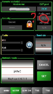

Hello! the program is excellent! works and blue tooth and wifi and through the 3G network! transceiver yaesu ft-991. Question the sound in the program is missing! what is the reason?
Did you configured the right audio interface in jAReC?
The TCP port for audio is automatically set to the next one after the port used for CAT, so you need to open that port too in the firewall.
