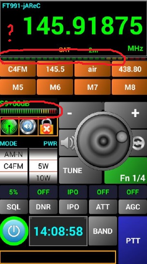

Post by RA6LFJ »
Thank you! version of Pocket RxTx version 0.9.0-20 is not stable! When you connect, you turn on the scan.
Новый точечный рисунок (6).jpg (69.3 KiB) Viewed 31225 times
Re: Experimental Pocket RxTx version (0.9) & jAReC 0.9
Please be aware that in version 0.9.x , when you start the application, all the button status are automatically applied, in order to revert to the status before last close
