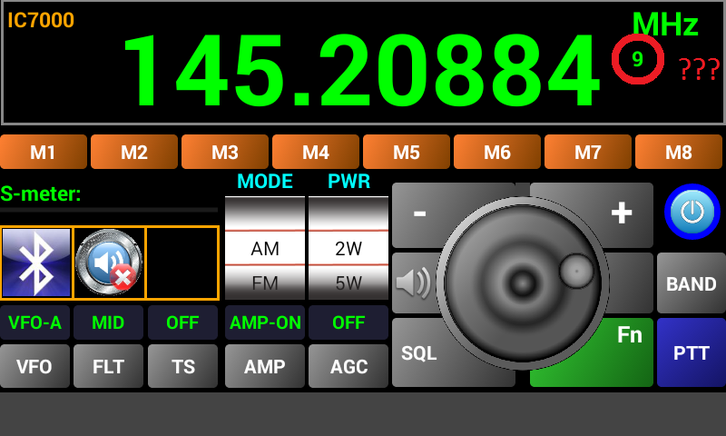

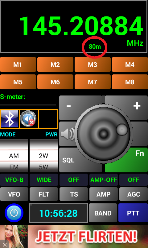

I am coming back to this thread because I am working on IC7000 config file again.
Noticed a few glitches.
1. wrong picture is shown for IC7000. (chanced in my config)
2. Powersetting shows LST2CMDS=CCMD_SET_... (CCMD_SET don't know if it matters, but changed to CMD_SET...)(looks like it is also in other config files)
3. After waking up from display timeout, Mode and Power setting are reverted to AM and 2W regardless the settings before.
obviously other settings are not affected.
4. Bluetooth fist always like to connect first to my PC instead showing up my Android. Is there a way if PRXTX has connected the wrong device to remove this on and prompt a new device scan?
5. Display glitches. Band did not match Frequency. Differs also depending the orientation. Look at picture.

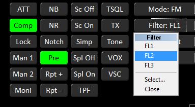

3. Although the filter settings work, but in a wrong way.
Normally the filters are changed by pressing a button once for filter 1, twice for filter 2 and so on.
I thought this would do the job:
CMD_SET_FILTER_WIDE=FE,FE,<A>,E0,1A,03,40,FD
CMD_SET_FILTER_MID=FE,FE,<A>,E0,1A,03,28,FD
CMD_SET_FILTER_NAR=FE,FE,<A>,E0,1A,03,22,FD
But it will only reprogram the actual filter setting in the radio. (They could also be used as subcommand to Mode setting.) Tried this with HRD Cat Command Tester.
For better understanding:
In case filter 1 (originally programed for widest setting) is set in the radio and
CMD_SET_FILTER_NAR=FE,FE,<A>,E0,1A,03,22,FD is accomplished, filter 1 is programed to narrow.
But the display did not change from FLT1 to FLT3. This although works and bandwidth is now changed, but when pushing
the filter button on the radio it does not change back to the widest setting, I remains in narrow.
To change back to wide, I have to change via menu or via
CMD_SET_FILTER_WIDE=FE,FE,<A>,E0,1A,03,40,FD.
This is not a big deal, but I wonder how it is done in HRD or BKT Control without reprograming the filter afterwards.
HRD IC7000 Filter.JPG (26.83 KiB) Viewed 30245 times
Is there a way to record the cat commands sent by an application? So it would be easy to see how they did it?
Display glitches?
In my current version I have cleaned up, rearranged some lines and added and removed (which did not make sense in IC7000) a few modes in my config file.
Will post the file once it is finished. ;)
73 de Sigi, DH1KLM
Re: No Bluetooth connection
Hi Sigi,
DH1KLM wrote:1. wrong picture is shown for IC7000. (chanced in my config)
This is a misspelling. I will correct it.
This is related to the way the wheels are refreshed after a display timeout. It seems that the setting is lost during standby. To be checked ...
You can initialize the connection through a long press on START button.
I'm aware of some. I will check it.
This is a list of the supported cat commands from HRD.
Have a look at Dropdown: Filter
