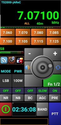

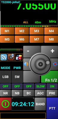

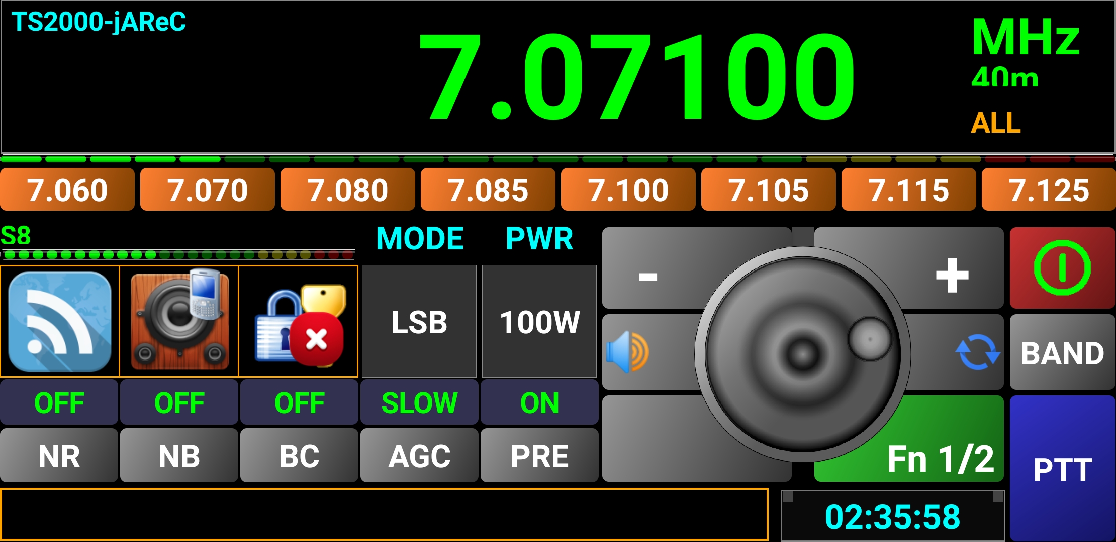

2. At the first loading PocketRxTx the position of the frequency display is not at the proper center until I rotate my handphone at least once, screenshot picture attached. I use Samsung Galaxy Note 9.

2. This happen only first time after installation or at each application start? From your picture it looks like the frequency is represented on two lines.

2. It's happened every time app just started

2. Did you tried to adjust the font size inside app? If you start when in landscape mode, the same happen? If yes, can you send a screenshot?

2. I think no need to change to font size, this issue only at every first time PocketRxTx started but when I rotated the phone to landscape and back to portrait the font size is looked fine. Some screenshoots of first started screen, ratoted in landscape and back to portrait attached.

2. I have another report with this issue, but unfortunately I was not able yet to reproduce it here. Please provide more details about Android version and device display resolution, to try this in an emulator.

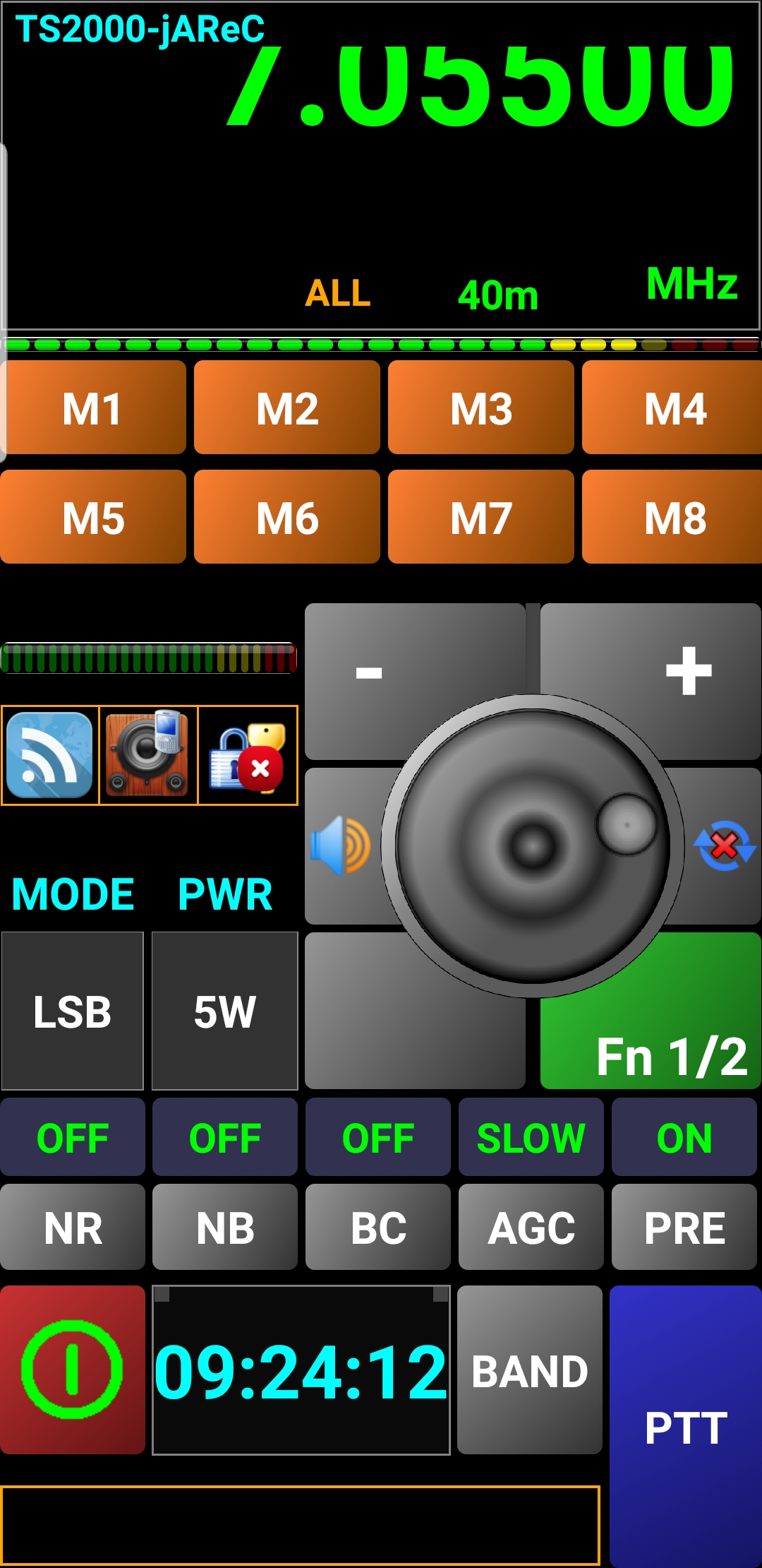

I installed Pocket RxTx v3.0-2 onto my Inrico T320 which I use for Amateur radio use when I am out of the Shack etc. It's great as it has a PTT button on the side.
I found the App worked really well with one exception. The T320 has a small screen with a resolution of only 240x320 and if I attempt to enter a frequency directly, the overlay extends beyond the bottom of the screen cutting off the C and Enter keys making entry impossible. It would be nice if the overlay could fit the screen.
