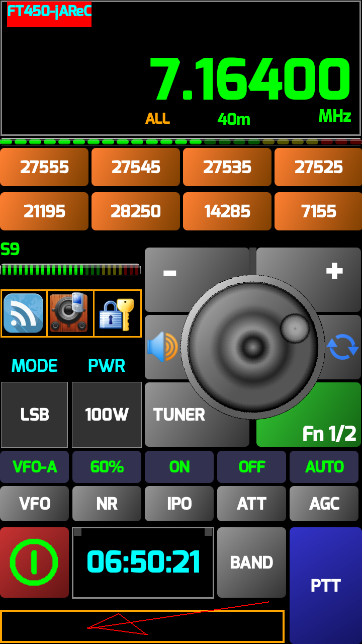

Just only out of curioucity... check the picture... its of course related to pocket-rxtx but was wondering what that empty box does there in the app.... is it for something for future updates ?

SY1DAL wrote: Tue Oct 12, 2021 3:05 pm Just only out of curioucity... check the picture... its of course related to pocket-rxtx but was wondering what that empty box does there in the app.... is it for something for future updates ?
Is a status info bar, where some messages are displayed, but in v4 will disappear, as it's eating valuable screen space.
Ok Dan, good to know... and its in indeed wasting space there as it can be useful to re-arrange stuff on the main area of screen to perhaps add more features / buttons :)
