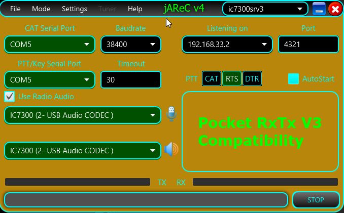

jAReC v4 will not start with RTS selected, only with CAT selected. this is true for server mode and for direct.
Let's clarify this sentence.
What do you mean by "jAReC v4 will not start with RTS selected"?
This is how jAReC v4b5 must look when you press on START in v3 compatibility mode with PTT over RTS.
I didn't test the bridge mode.
This is a generic mode, for general use, let's forget about it.

This is really strange, as I cannot reproduce this behavior here.
Please use current jAReC v4.0.5 for java 1.8.xx from here (works with both 32 and 64 bit versions of windows, but only with Oracle jre 1.8.xxx):
https://www.yo3ggx.ro/jAReC/v4/jAReC_v4 ... _oct29.jar
This is almost the final v4.0.5, if nothing really wrong will be discovered in between.
Will be officially released together with Pocket RxTx v4b5.
P.S. You can attach the picture here directly, no need to create a PDF file.

If you don't select AutoStart and click on START manually after the COM port is set to green you get the same error?
The error occurs if when the app tries to auto start the COM port is not yet confirmed as available (set to green ). Currently I have a delay on AutoStart, but seems not to be enough for your setup. I modified the code to try to auto start only after the port is set to green. This must solve your issue.
