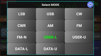

Hallo,
I'm using the app to control my yaesu FT 950 but I've a very narrow band in RX with mode USER-L (must used to enable rear input and not MIC).
Before, with Yaesu FT 450 D, worked well…..
Can anyone help to me?
73' de IW0HJQ Pat

Hi Pat,
USER-L mode does not exist for FT950. For sure you are using the current config from the central repository?

Dan,
I use the last pro version and tried a Free version.....
Here the image of the mode selection.
The few bandwith is like the pkt /rtty button on the keyboard.
I not find any information about some filters in that mode.....
Thank you for the support!

Hallo Dan,
sorry, the version of the App don't was the last release, but the problem is the same:
I must use PKT mode to enable rear input but the audio width is not good.
I tried to set wide and wide2 in the second function Key without result.
the shortcut is use the front mic with another sound card ( I've the SCU 17) but in this time haven't a transformer to isolate the signal .

Hi Pat,
Sorry for the late reply, but I'm in a very busy period with no time at all for the app development.
To set bandwidth, the "SH" CAT command is used.
Parameters depends on mode, as in the following table:
You must set the parameters for the filters according to your needs. In the existing config, only the following values are used: 00, 01, 04 , 09 and 13. What other values you need?
