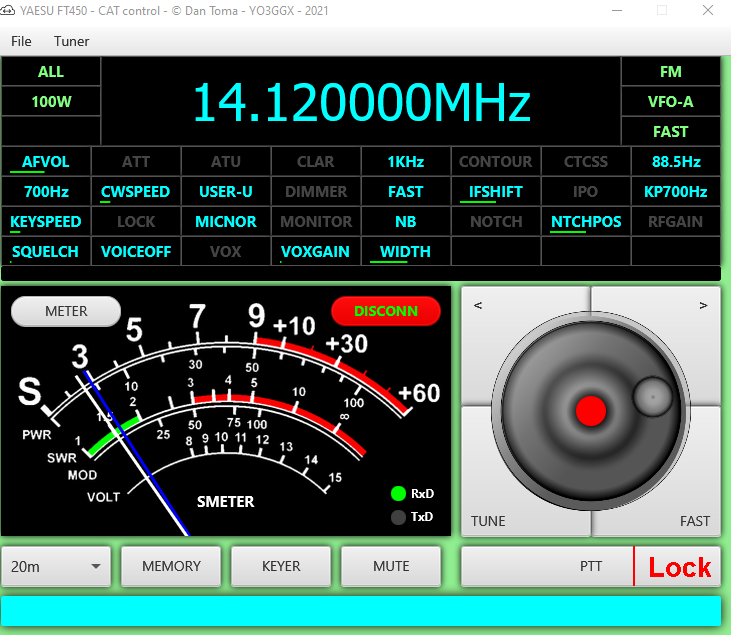

2. as for the main direct operation of Jarec v4b9 i see that sometimes (quite less times... perhaps 2 in every 12 clicks of the PTT) still the meter goes to 0. But its very very rare... but it happens. It is tho smoother in its movement (which is very nice).
3. When i click on either the meter (to select between swr or pwr or any other) the small box goes in the back of the main screen so i have to move with the mouse the main screen in order to see the other small box. I saw that meter box opens on the right side .... and band selection on another position... the pwr adjuestement box goes to the left side... One thing to notice is that when these "popup" boxes open... the focus is on these boxes and so when you move your mouse outside the frame of small boxes and try to press a button on the main screen it doesn't work. I am trying to say that the small boxes are trying to keep the focus (its like move to the back or move to the front.... an element to make it active) .

Will help me debug this if you can find a pattern to reproduce the issue here.2. as for the main direct operation of Jarec v4b9 i see that sometimes (quite less times... perhaps 2 in every 12 clicks of the PTT) still the meter goes to 0. But its very very rare... but it happens. It is tho smoother in its movement (which is very nice).
I am aware about this issue in v4b9. Please confirm that this happen only if you activate Always On Top feature.3. When i click on either the meter (to select between swr or pwr or any other) the small box goes in the back of the main screen so i have to move with the mouse the main screen in order to see the other small box. I saw that meter box opens on the right side .... and band selection on another position... the pwr adjuestement box goes to the left side... One thing to notice is that when these "popup" boxes open... the focus is on these boxes and so when you move your mouse outside the frame of small boxes and try to press a button on the main screen it doesn't work. I am trying to say that the small boxes are trying to keep the focus (its like move to the back or move to the front.... an element to make it active) .

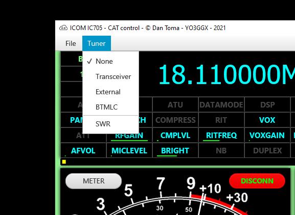

I forgot to mention Tuner functionalities.
- None - no tuner available at all. TUNE button will have no effect
- Transceiver - When TUNE pressed, SET_ATU=TUNE is executed (if defined in the radio config)
- External - While TUNE button is pressed, the radio is set to 1W, mode to AM and PTT to ON. This can help you tune using an external standalone tuner. When released, the radio TXPWR and MODE are set back to previous values.
- BTMLC - This activate the control for my BTMLC tuner (Bluetooth Magnetic Loop Controller tuner). This feature is not fully developed yet, but the hardware was already being presented in a MAGLOOP Facebook group. This allows wireless automatic tuning for any magnetic loop antenna.

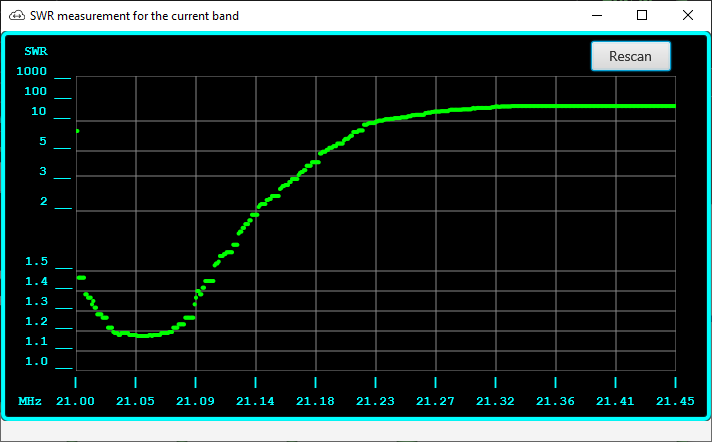

- SWR - The SWR measurement is started for the current band and a graph is displayed. Measurement is performed with 1W and AM.
If you test this feature, I would like to get your feedback.

I prefer to keep it optional, as you may want to use the app in the background just for receive, using the headset and do something else on the PC in the same time.
Anyway, if you set Always On Top, this is saved in the configuration file (jsn.cfg), so no need to re-activate when you restart the application.
Yes. Keyboard shortcuts are already on the wish list and will be available in the next beta version, not only for PTT, but for other commands too (tune, meter select, SWR measurement, KEYER, mute, etc.I have another suggestion or idea. It would be possible to assign the option of assigning a key on the keyboard to be able to activate or block ptt, so that you can have your hands free without having to use the mouse. Thanks.

I have to video links of video screenshots regarding the power meter test and also the test of SWR functionality.
1. Power Meter test (to catch the 0) https://www.iplayradio.net/cdn/files/pu ... r-zero.avi
2. SWR test https://www.iplayradio.net/cdn/files/pu ... -again.avi

Keyboard shortcuts are always nice to have in any application. But i would definetely suggest a PTT lock function in the main PTT button (i have attached a picture / no my best design tho hehehe).yo3ggx wrote:Yes. Keyboard shortcuts are already on the wish list and will be available in the next beta version, not only for PTT, but for other commands too (tune, meter select, SWR measurement, KEYER, mute, etc.
I am also aware and saw the tuner functionatilies... I have selected "transceiver" option for me as i use the internal tuner of the radio (ft-450) but since my antenna is with swr 1.1 on 4 bands... i never use nowadays.
