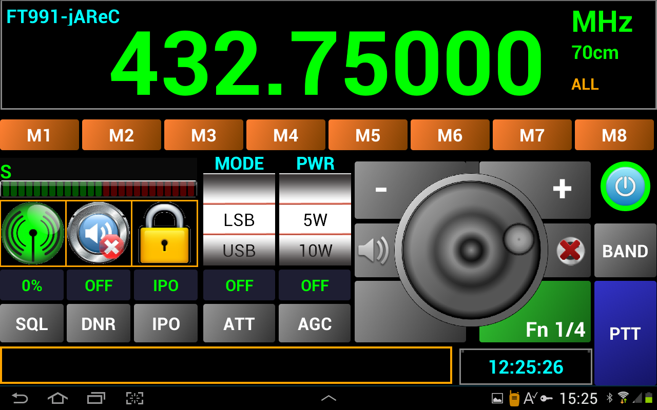

I'm talking about the button in the right part of the tuning knob.
When disabled, a red cross is over the "sync" button.

It looks like your interface is locked. If you long press on Fn button when the radio is on, then you lock the interface and the label of the Fn button goes"LOCKED".
