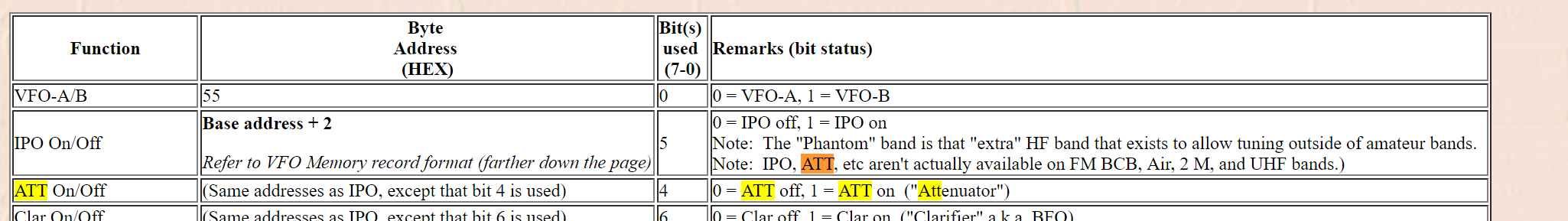

I tried Pocket RxTx with my FT-817 via usb and bluetooth connections. I increased bluetooth speed at 38.400 and works just fine. I have some issue with some commands such Att on/off. Looking in the radio config. file I saw that command Att on/off is defined but the opcode is not present. User manual refers only to 17 commands and I hope someone would help me to find the opcode for att on/off and maybe other undocumented commands(IPO???)
Mny tnx, Ovidiu
Mny tnx, Ovidiu
Re: Yaesu radios config files
Hi Ovidiu,
If you take a look here:
http://www.ka7oei.com/ft817_meow.html The problem is that this setting is per band, so you must define one command per each band.
