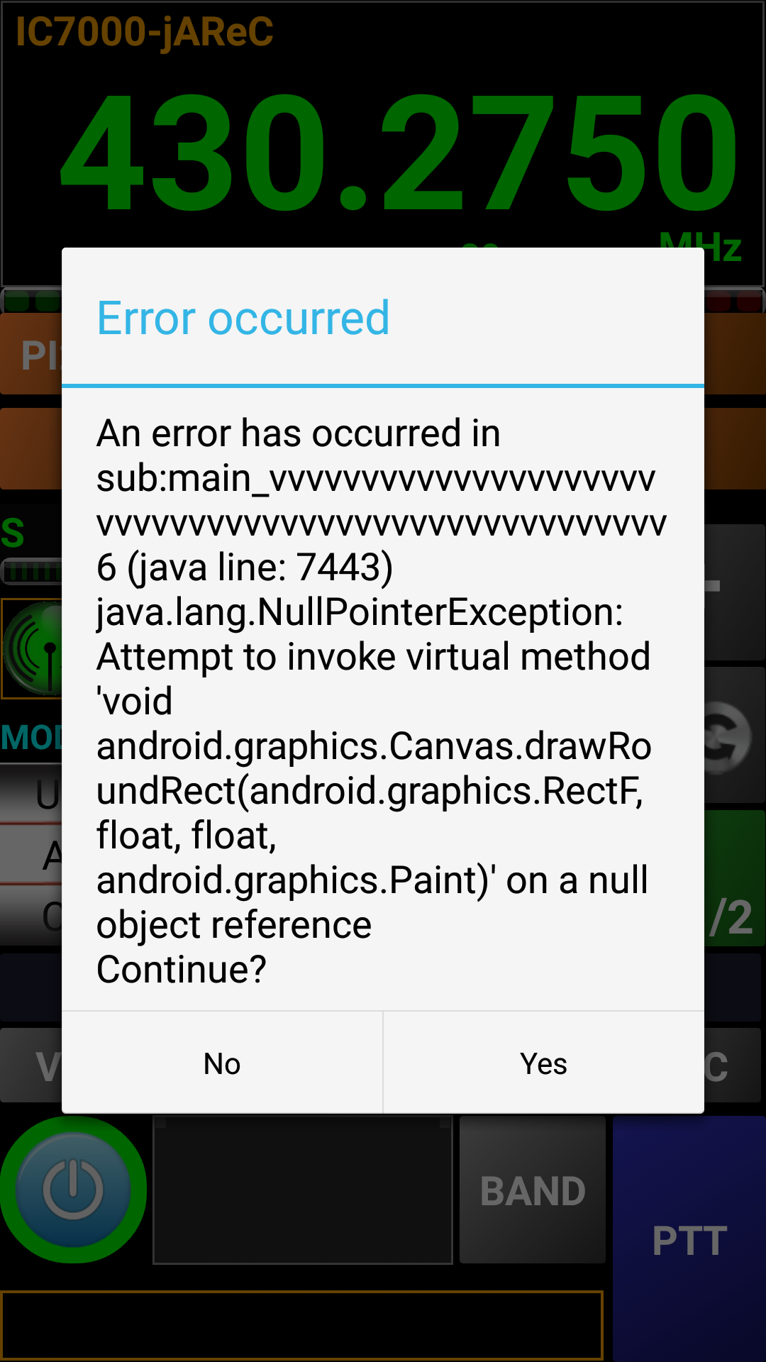

I did remove everything but it still get freezing screen. just a minute ago audio was also running but the rig was set to AM mode and none of the button react. I received a error message that popped up. I made a screen shot. I attach it to my post

I can not recall exactly after what action I got the message.
And yes I received the selection option regarding CAT or Web SDR. I also see the hardbeat running well. left the small yellow/orange dot en right the green dot. but the app doesn't sync with the RIG. the RIG is set to 0.030 MHz in LSB and I heard noise. But non of the buttons are working however if I touch a button I see the green dot acting.

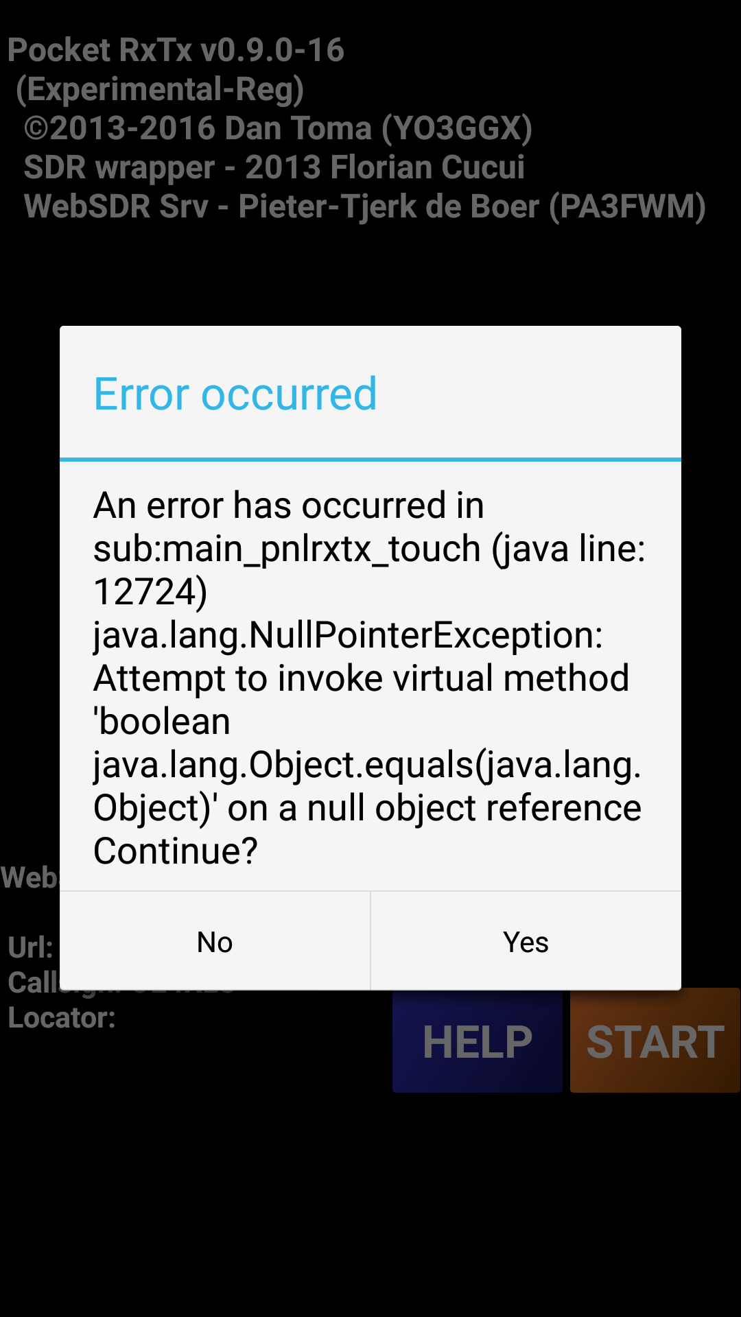

After installing the version 0.8 I installed the version 0.9 just to see what would happen.
I had audio but the RIG was set to LSB. frequency was not changed and non of the buttons act on touching. once again haertbeat yellow and green wher eblinking.
after leaving the program I received beliwe message.
