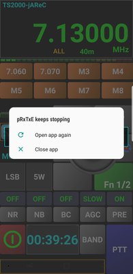

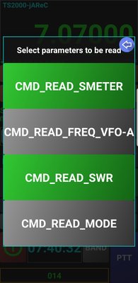

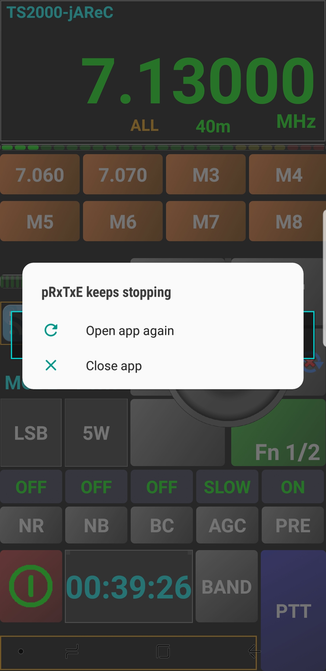

I tried new version 3.05b, I have bug experience.
First time run everything is fine until I tried to select more than one parameter for S Meter, let say S signal for RX and SWR for TX, suddenly application close automatically.
When I try to restart, application always back to close again. There is pop up menu to open again, unfortunately didn't work.
I tried uninstall and reinstall but didn't help.
Screenshot for this condition as attached.
Regards
73. Nuril YC1UTC

Hi Nuril,
I have another report with the same issue with the TS2000 config and Pocket RxTx 3b5. I will check if there is any incompatibility between the config and the new version. Anyway, I hope to be able to release 3b6 together with the updated user guide in about 1 week from now.

Hi Nuril,
I've found an error in the radio config. It was a space before "CMD_READ_SWR" in the POLLING line.
Corrected now, so please check again with b5 and default config for TS2000. In b6 I will implement a safety check/autocorrection for the config file.
