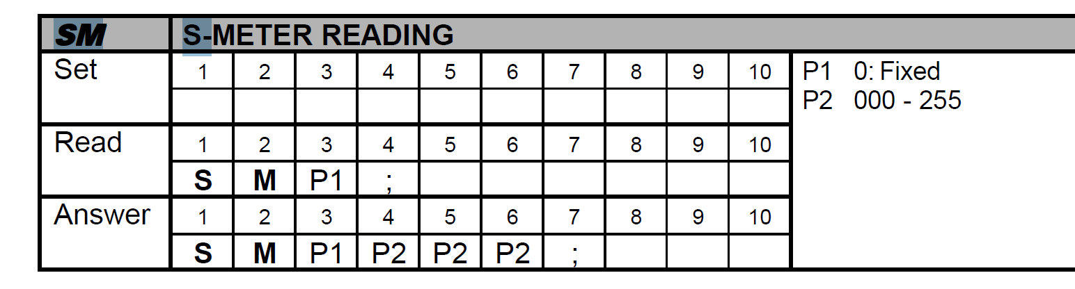

SY1DAL wrote: Mon Oct 18, 2021 2:08 pm I wasn't aware about that part... that i have to make calibration. I do not know how to do that.
READ_SMETER return a value between 0 and 255, according to the FT450 CAT operation guide.
To associate this value with a specific S level, there is a tag in the radio configuration file named "CAL_SMETER"
Current definition for FT450 is:
CAL_SMETER=0=0;16=100;41=200;58=300;74=400;90=500;107=600;118=700;137=800;156=900;173=910;189=920;206=930;222=940;238=950;255=960;
So.. for value=0, S=S0, for value=16, S=S1, ,,, , for value=156, S=S9, ... for value=206,S=S9+30dB and so on.
This was created based on the answer received from my FT450 transceiver.
You must use Configuration Builder and send READ_SMETER commands, check returned value from the radio for different S levels and then adjust CAL_SMETER line in the yaesu_ft450.radio local file.
All intermediary values are interpolated internally by the application. Same applies for all meters.
I am aware of the smeter reading.. i also have that manual :)

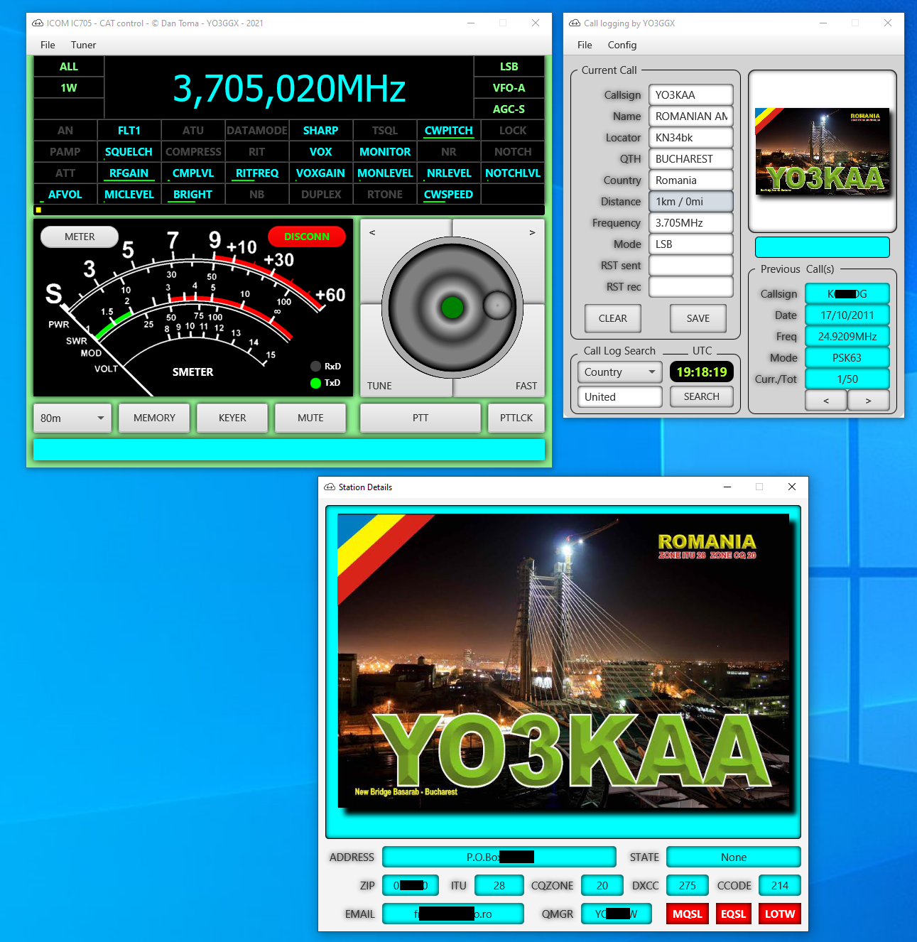

Besides some minor changes and bug fixes, this version add a new functionality: Call Logging, fully integrated with the rest of the application.
Some of the features:
- support for QRZ queries. This feature require a QRZ XML subscription.
- extract all available statiuon info from QRZ
- use ADIF v3 as standard file format (New/Open?Save)
- if you load your existing Call Log in ADIF format (ex. saved from QRZ), you have the options to do searches based on several tags.
- you can display with a simple click the web page of the user (if <web> tag is defined, or the QRZ page if personal web page not available.
- frequency and mode are automatically entered when tuning the radio through jAReC
- start and end time of the call are automatically saved in the ADIF record at the end of the call
As the user manual is not yet ready, here are some hints about the new features:
This is how it looks.
Enter your callsign, username and password for QRZ.com using the Config menu
Enter the callsign (case insensitive) and press ENTER
All fields are automatically filled by querying QRZ database
Click on the small picture to open the window with more details
Click on the big picture to open the web page of the user or his QRZ page
To search through the call log, select from the dropdown list the parameter you want to search for. Partial text is accepted (ex. if you want to search for all the calls with US, select Country and enter "United" then press Search
The number of calls is displayed in the Curr./Total field. Click '<' or '>' to browse through the results.
Clicking on the Callsign in the "Previous Call(s) frame, a query is started in QRZ.conm for the respective callsign
