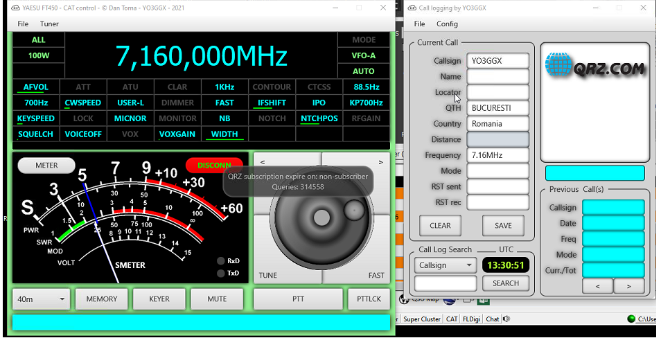

Well i made a screenshot.
I get this message now when i click on CONFIG menu "(re)get QRZ key .
When i type the callsign - in this example yours, i get info, but the frequency was not displayed immediately.
It took some seconds delay (approx. 30sec) before it got displayed (in our example 7.16Mhz) .
Noticed also that in CONFIG menu, the option "extra info" is not saved. Once you quit the app. You have to go again there and enable that.
Also as you can see in the screenshot, the MODE is again not displayed. You have to click with mouse to change it. So for some reason... it reads all other data but MODE is not read upon opening the app in DIRECT MODE. And a weird thing is, that my radio was on frequency 7.16 (as per my example above) but when i close direct mode and re-open again, after i click on the CONNECT red button it displays frequency 7.130 instead. Why isn't it reading properly from the radio ?
One other thing i noticed is the logging feature, each time i press L (shortcut) it ask me to save ADIF file. And i give a name and it says it will start with an empty adif file. After i save a QSO it asks me to save a new ADIF file that has my callsign in the filename instead of saving the first ADIF file i was asked. Perhaps i might have to demonstrate this with a video.
I also believe that the once you click on the SAVE button, in the logging feature, all fields must be cleared except for the frequency, unless you change frequency / band. Because now you have to press the CLEAR button in order to write the next callsign to save a new QSO.
One last thing i discovered is that when you have LOGGING enabled (by pressing L) if you close the window on the left (direct mode) the LOGGING window still stays ON and you have to press only X in the corner to close it.

Re: jAReC version 4 beta versions
SY1DAL wrote: Wed Oct 20, 2021 4:46 pm I get this message now when i click on CONFIG menu "(re)get QRZ key .
This is a normal message and means that you successfuly get the key to querry the database.
The frequency is writtem when you tune the radio (same for mode), is not something you get from QRZ.
It takes until you change it.
That menu item is no more used, I forgot to remove it. To get extra info you must click on the station picture. Anyway, I have doubts you can get extra info from QRZ without a paid subscription. A I can see, you get only Country.
If you start call logging before connecting to the radio, both mode and frequency will be displayed. I will change in the next release to get it automatically if the radio is already on
You're sure you didn't touched the mouse wheel when pressing on connect? I've checked here and it stays on the same freq.
I think is a bug. Didn't fully tested all possible sequences.. Try to open an adif file (File open) and then close logging and start it again. You must not be asked anything from now on.
Another bug for v4b13

Let me explain... when you open the main window... you are already on a frequency. Lets assume that you are already on 7.160... so you hear operator calling CQ and you want to make QSO. So you reply to him, he responds, and then you type his callsign next to the LOGGING window. So why does it take 30 seconds for the frequency you are already tuned to be displayed ? I know that the frequency is not grabbed by QRZ.... qrz has nothing to do with the QSO you are in progress with... :)
In Pocket-RXTX is the same thing and way more faster.... because you are already in a frequency when you open the app... all you do is tap on the UTC time clock to save the QSO.
On Pocket RXTX with my current free version account of QRZ i am getting these details automatically fill in "Name, Locator (sometimes), QTH, Country" . So that means that also in Jarec logging feature i must have the same details as well. Right ? Frequency is self-explnatory that it will be automatically filled but its not necessery to first tune the dial.... I am not sure if i am explaining it correctly :)
It doesn't make sense to open up first call logging and then press connect button . But even if the user does that, when he press the connect button that means that the radio is ON or auto-powered on if enabled in settings. Then the first thing that must happen is to read all values from the radio and display them on screen window. Therefore the MODE must be always displayed.... whats the point in displaying the frequency but without its current MODE (lsb, usb, fm, am et.c) - then the user doesn't actually know which mode the radio is.
I have to try this again to be sure... and we both know that if this happened due to the scroll wheel of the mouse... then for sure in the next version you must allow for the mouse wheel to only change value when in FOCUS of the window. When its not in focus its must not change anything :)
