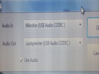

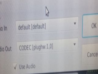

Hello @LL,
Are there some Linux Freaks present?
I usually work with Linux.
And work with DAN's jAReC v0.9.0-17
I often have the problem that I have several times !!! Between the JAVA application and another program before I can select the USB0 codec.
see Picture...
Codec_linux
Codec_linux
I work with my Icom IC-7300 very much in digital modes such as FLDIGI, QSSTV, DRM, JT9 / 65 and so on.
All these programs run flawlessly and do not have this problem.
Does anyone have an idea what I can possibly solve the problem?
Hardware I can thus I think exclude, because all other programs run flawlessly.
To mention maybe, the SIMPLE laptop and same jAReC version under Windows seems to have no problem.
Codec_windows
Codec_windows
So if a Linux user has an idea, I would be happy.
Greetings from Germany
73 de DO1Di / Dieter
Re: Experimental Pocket RxTx version (0.9) & jAReC 0.9
Hi Dieter,
Seems to be an issue related to the Java subsystem. Sometimes audio devices are not correctly recognized. I'm using both Linux and Windows versions of fldigi myself too and encountered the same problem with jarec on an Orange Pi Zero.
Please download a new experimental version of jarecmini (no GUI) from the link below:
https://www.yo3ggx.ro/jAReC/jarecmini_v0.9.0-18.jar
and run it from the linux console with 'java -jar jarecmini_v0.9.0-18.jar' , without any config file.
Please post here the list of audio devices you get when you run it. Normally in the new jarecmini you can select the default audio device for both Input and Output, so check that the USB audio is the default one.
Please tell me the java runtime version installed on your linux computer.
In fldigi what audio subsystem is selected? (OSS, PortAudio or PulseAudio)?
Please check that the user running java has access to the selected audio device.
