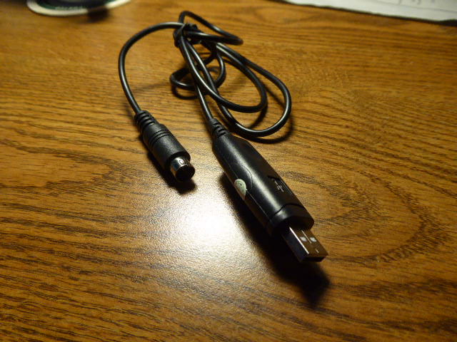

I have attached a picture of my USB CAT interface. This works well with my FT-817/857 using Ham Radio Deluxe as well as CHIRP and other
programs.
Are you saying one of the pins on its 8 pin din contains 5 volts to feed the Bluetooth CAT interface?
The inline 8 pin din looks almost right but the second row of 3 pins should have a space between 2 of its pins
larger than the other. . . . It should look something like that.. The picture on ebay you pointed out doesn't appear
to have that space.
Ken
N1KK
programs.
to have that space.
Ken
N1KK

Re: Blue tooth Dongle by KA6PSD
Ooooooops!
Sorry!
You are talking about an USB CAT cable, not a standard USB/Serial module like this one:
http://www.ebay.co.uk/itm/Brand-New-CH3 ... SweW5VJPBn
You can use that one too, but then you need to provide power (ex. +12V) to the Bluetooth module on the specified pin, from a separate power supply (ex the one used to power the transceiver). The USB CAT cable uses only Rx, Tx and GND.
You can use 2 miniDIN 8-pin female connectors wired as follows:
BT <--> USB
Rx <--> Tx
Tx <--> Rx
GND <-->GND
+13.8V <--> not connected to the USB/Serial cable, but to an external power supply.
Because the USB/Serial cable works with TTL levels (+5V) you can put some small resistors between the data connections, but from my experience the bluetooth module can handle +5V too.
Hope is clear now.
Sorry!
BT <--> USB
Rx <--> Tx
Tx <--> Rx
GND <-->GND
Hope is clear now.
