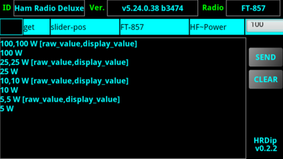

I played with HRD Ip.
Here is a picture of my screen after this manipulations:
set slider pos .. HF Power 5W
get slider pos .. HF Power
set slider pos .. HF Power 10W
set slider pos .. HF Power 25W
set slider pos .. HF Power 100W
I'm not sure if it's what you expected from me.

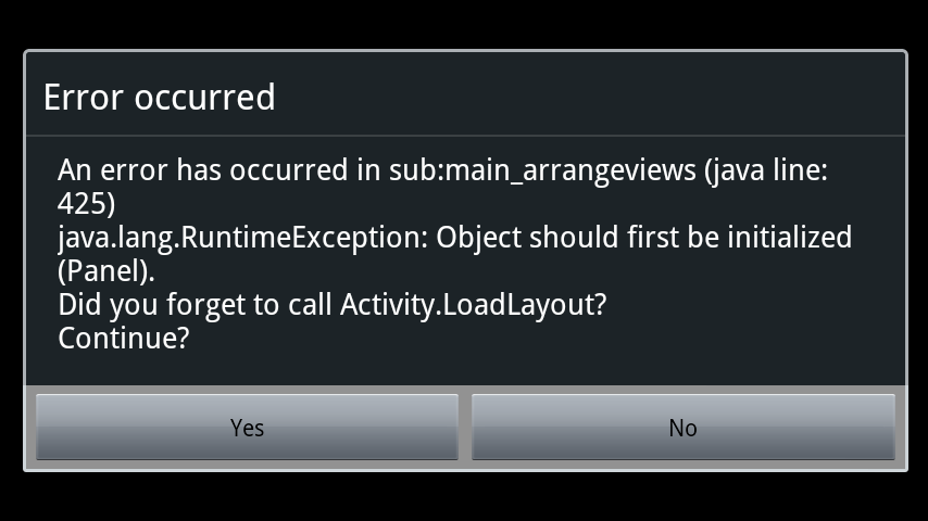

I seen a bug in HRD ip, on my phone, if i let the screen coming black (i mean like the screensaver of the phone)
If i hurry up my phone, i get an error:
Hope it help!
if i can help you again, you can ask me to try something, i'll be glad to do it for you.
