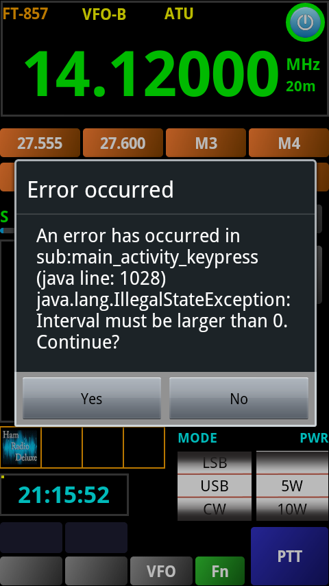

Hi again, i got an error when trying to PTT from camera button.
Re: Test of v0.6
Hi Fredo,
Please tell me the exact steps to replicate this error.
