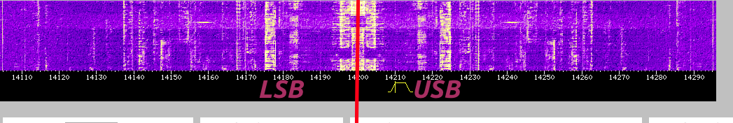

PA3FWM told me to be using the command "swapiq" to solve the sound problem as in the image attached.
here I definitely need your help to compile the command line to activate the I / Q to avoid the reflection of the audio spectrum.

This is not because of swapping channels, but because you have a mono audio signal (only one of the channels or the two channles are conncted in parallel.2) Output I / Q.

Re: UBUNTU-WEBSDR NOVICE
Hello Dan
as I am ashamed!!
The cable is mono! (see immaggine)
I never thought the cable.
Now it seems to work properly.

as I am ashamed!!
