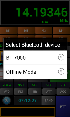

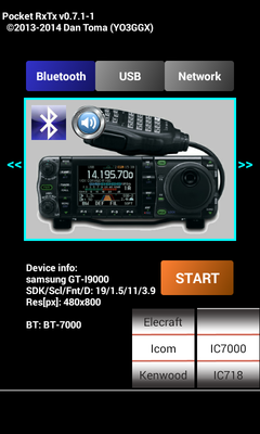

updated to Version v0.7.1-1, app is now starting, but my IC7000 can not be controlled
via Bluetooth. Connection Speed is set to 19200 baud. Tried other baud rates with no
success, Bluetooth connection seems to be established but radio did not respond.
TRX can be controlled via Bluetooth with Notebook running Ham Radio Deluxe, so my dongle is working.
Will try another mobile phone tomorrow.
73 de Sigi, DH1KLM

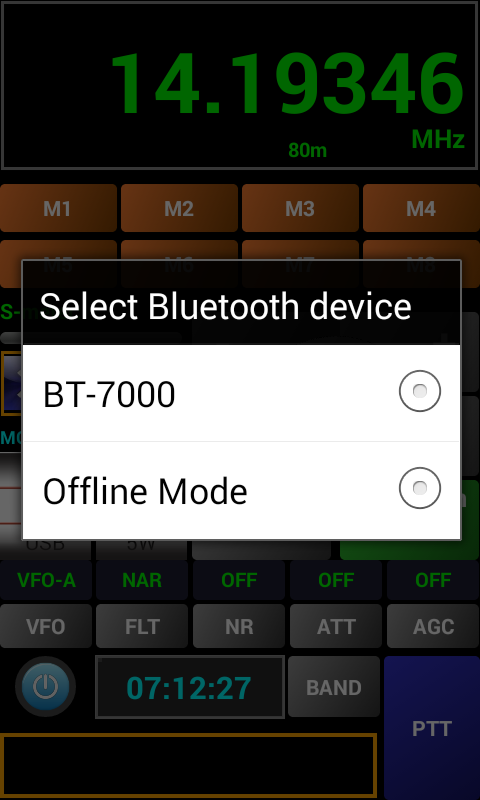

Good morning Dan,
just tested on other mobile phone, same problem here, dongle is recognized
but so far no communication with TRX possible.
Paring with dongle is done and the name also showed up in start screen.
Is there a way to log the Bluetooth traffic between mobile phone and dongle?
Does it make sense to install a older version?
73 de Sigi

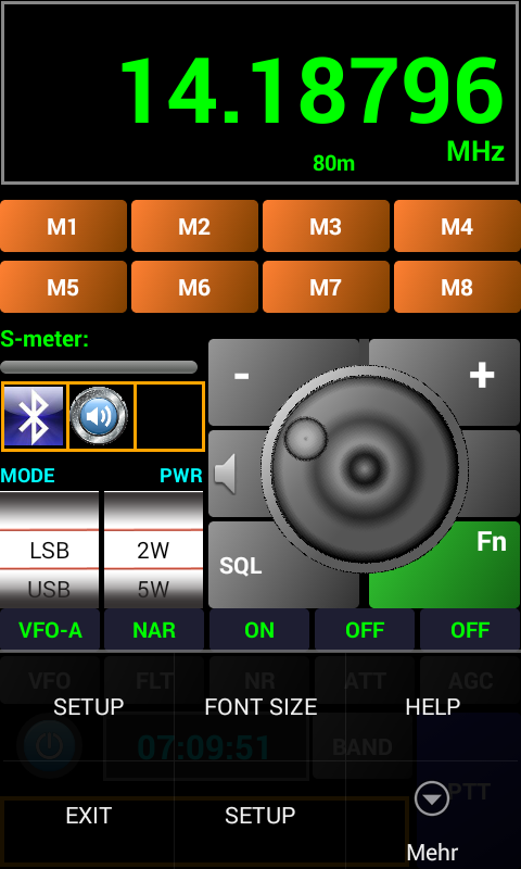

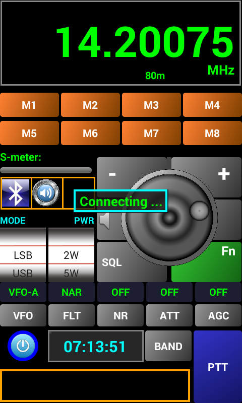

Here are some screenshots I've made.
so far i did not find a button that actually works, but will give it a try once more.
[edit]
no function found that works
[/edit]
Re: No Bluetooth connection
Hi Sigi,
When you long press on round blue power button, the virtual round led around it goes blue?
I cannot see from the screenshot because of the menu which is open.
In a few minutes I will send you the link to a new version of pocketrxtx supporting logging.
