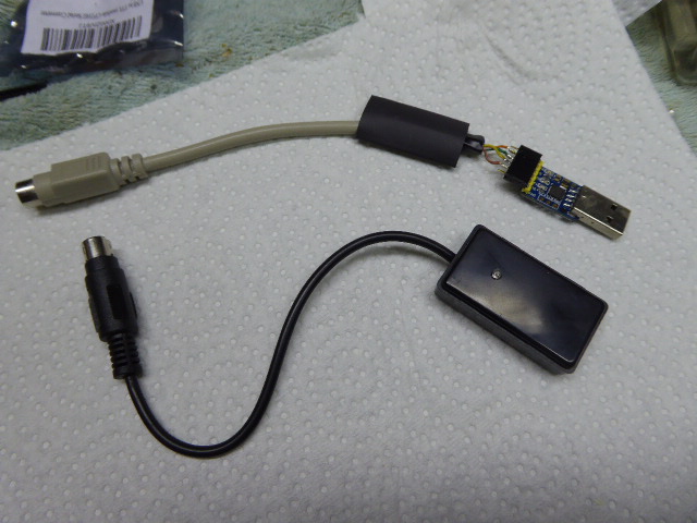

I have included a picture of the ebay Bluetooth Cat interface and the USB-->TTL programmer for it.
The grey cable has a female 8 pin din. The USB-->TTL powers the Bluetooth Cat interface.
Works good using one of your programs to program the Bluetooth Cat.
