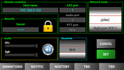

Hallo my name is Svante and callsign sm6usu. I have tried to setup Android Pocket tranciever but couldnt get it to work all the way First I have the Beta version 09-20 to 09.0-17 on Windows 10 . If I set the network mode to the 3 lines from up to down JAReC RigExpert WTI-1 and last Droid ARC All parameters on that setting side is avaible so good so far. When I push set and the power up I get Autentication time out and the jAReC remane yellow with no change. Step 2 set the network mode to first line nothing second line jAReC and last line RigExpert WTI-1 Then only hostname catport and security is avaible Not audio port no ptt port no Baudrate and not the square Audio with the speaker symbol
Now I have connection to my Icom and can change frequensy but no audio no ptt but the Jarec 09.0-17 is green and go to red when activate the ptt. But no Audio and no PTT function. So activate the version v0.8.1-1 and I get audio and ptt activates on my pc but no ptt activate the radio and the network link is also very unstable. So Is there any way I can listen to the station audio and activate the ptt in the radio I use network connection and I have a icom CT-17 usb CAT Control cable with drivers from miklor.com. I really want to run my radio remote if it is possible.

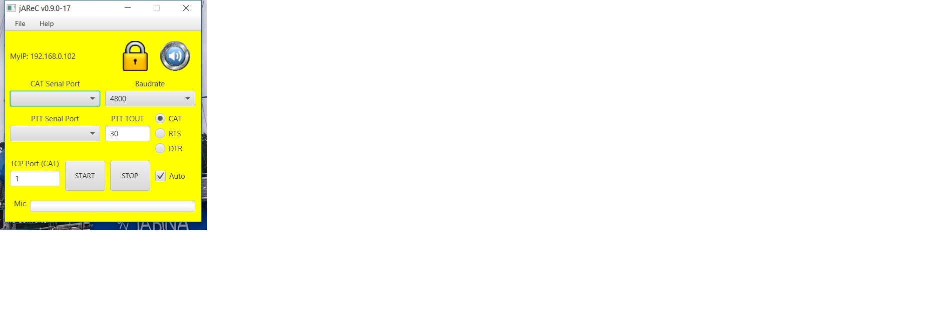

I've received your screenshots sent by e-mail (attached).
Please do not use TCP ports lower than 1024, usually the ports below 1024 are reserved. The port used by CAT and the next one (used for audio) must be free on the PC where jAReC is running.
The jsn.cfg file and the screenshot from jAReC contains totally different configurations. Which one is real? In the GUI I see no CAT COM port selected.
You stated something about a CI-V CAT interface (CT17) used to control your radio. This interface is used for CAT only, soes not have audio support. Do you have a data interface too, with audio support, connected to your radio? If not, you have no way to pass the audio back to Pocket RxTx. Audio cannot be passed over a serial connection.

Hallo ok I found that I had 2 jsn.cfg so the one I copied to the forum was false of course. Ok that one is now deleted and I have a jsn wich compare good to the jAReC 09-17. But how do I find the port above 1024 to use I can change frequensy on port 1 but no ptt (on tranciever) but on pc. I have tried som 4 figures number without luck Cant connect to tranciever at all. Is there a way to find out wich port to use. I understand that my audio not will work. But in the 08 version I could here station in my Android. In the 09 I can adjust frequensy power and so on IF I use port 1 but no audio either way and no ptt.. ??
