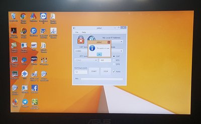

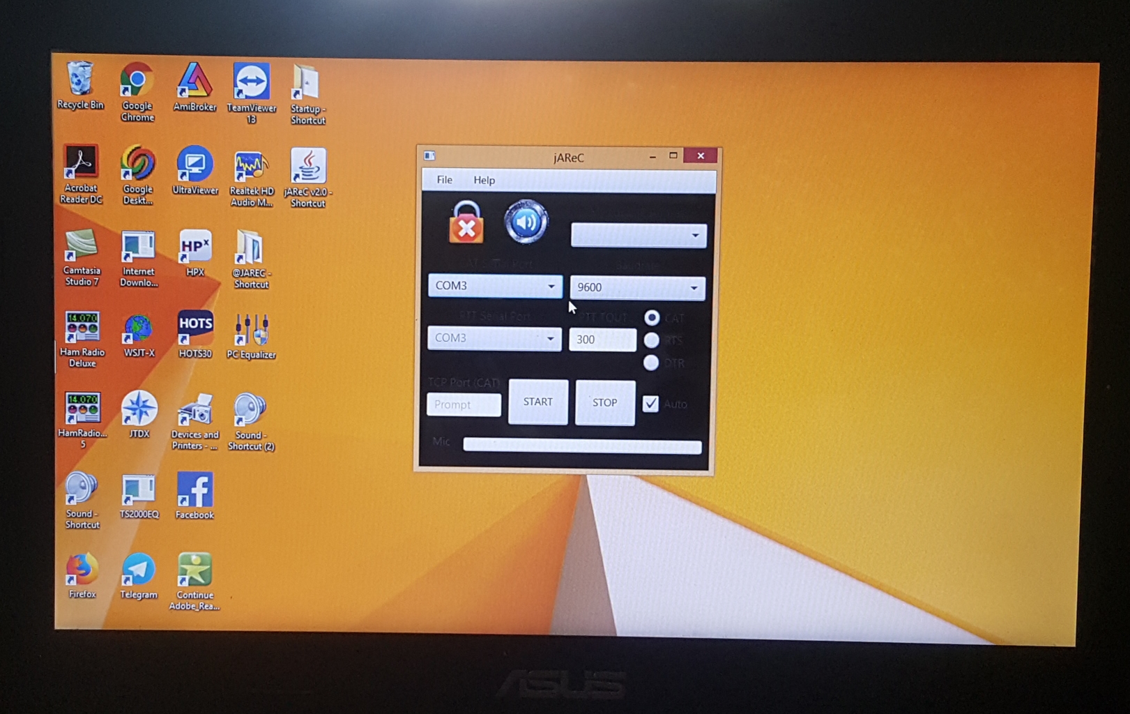

I installed new version 3.04b.
All function in version 2 is working great.
Import/export and modify config in running well.
I upgraded the Java app to 1.8 already.
But my recently problem as I told you before thats JArec in my computer looked working in unstable condition still exist.
First time running everything is fine. But after closed from remote, in a view minute after I can not connect again to my computer.
I see there is pop up menu in front of running Jarec application in computer that indicate the port is in use.
When I close this pop up menu, the Jarec app background become black color.
I try to close running Jarec app but did not work.
I try to look up in Task Manager to see what actually java app is still running, and try to shutdown Jarec but nothing to see.
The one way to overcome this issue just to restart the computer, but the problem will come again after one or two times remotely.
Would you advice what actually happened.
Thanks.
Nuril Mustofa YC1UTC
