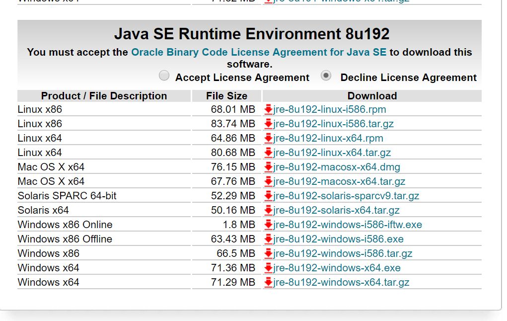

What Java runtime version are you using?
jAReC does not support version 10 or 11, only the latest 1.8.
You can download it from here (8u192):
https://www.oracle.com/technetwork/java ... 33155.html

Thanks,
That seems to work.
So far no shutdown.
I was running 8u191 (the suggested version if you just go to the Java download page.)
Version 8u192 does not even show up on that page.
Your link worked beautifully.
I will give it a good testing latter today, but so far everything looks good.

When I searched for the Java Runtime I just googled the net.
Here is where it steered me to.
(Their suggestion for Windows 10)
https://java.com/en/download/win10.jsp
As you can see it suggested version 8u191.
Once you pointed me to the other Java download page, I downloaded the correct version needed (8u192) and now all is well.
