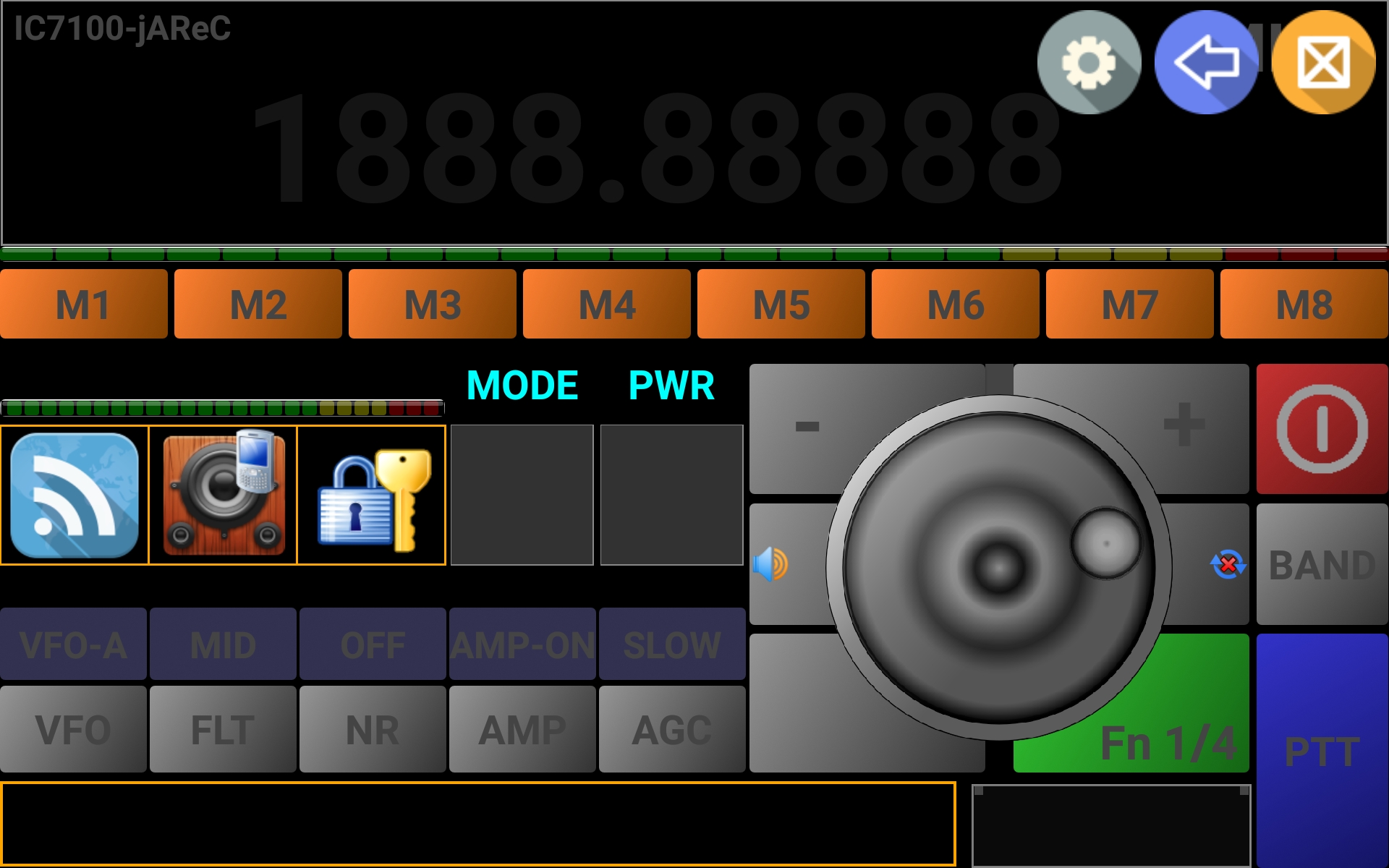

I have noticed that with the default IC-7100 Configuration File the radio starts up with all sorts of odd setting such as DUP- and PAMP1 etc.... How are the default radio settings established and saved?

Hello Chris,
In version 3, all the available settings in the radio config are set to the first value from the list when you first run the application.
As soon as you set them to the desired value and disconnect, all parameters are saved in the memory location 0 and loaded when the application is started again.

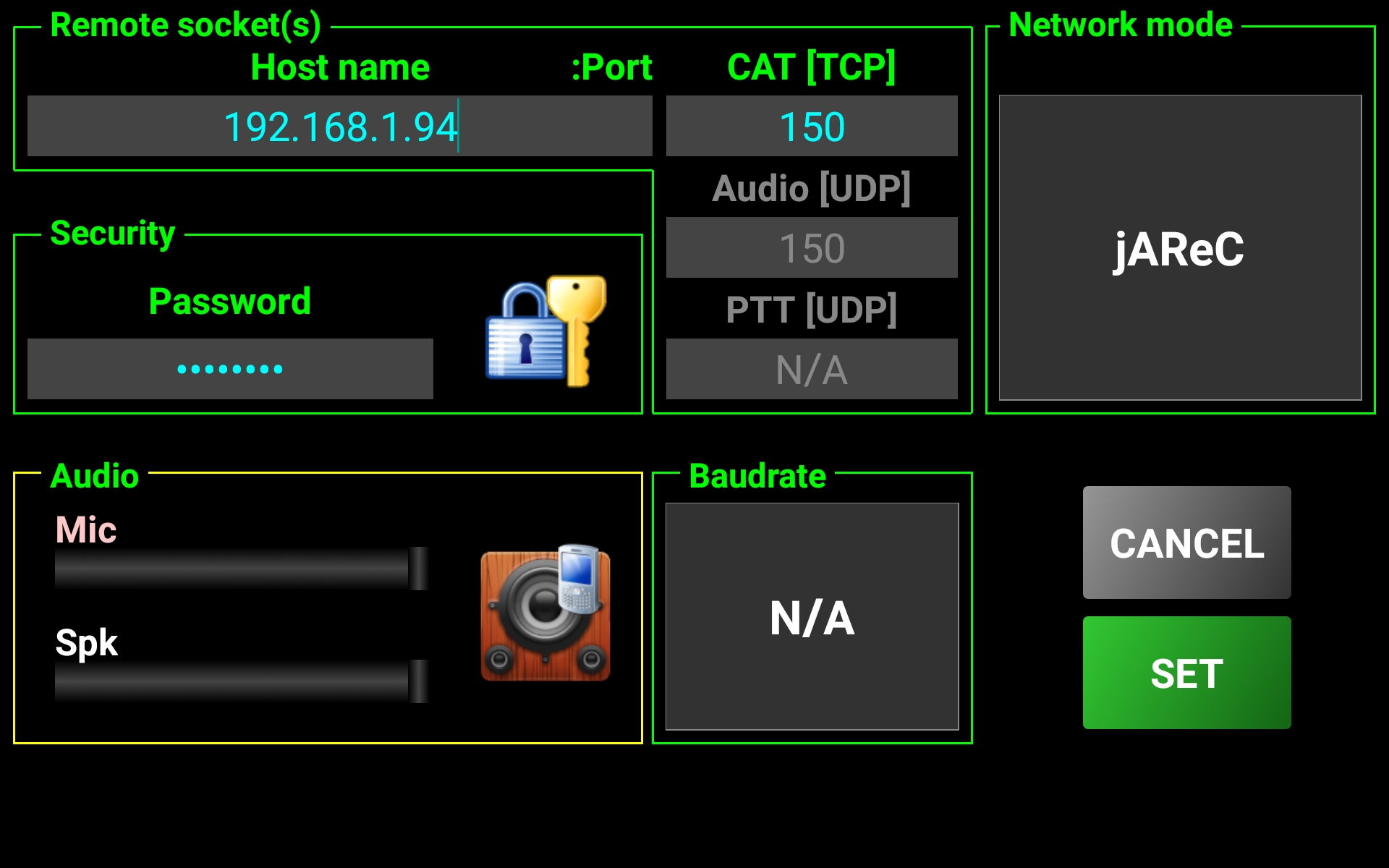

jAReC v3.0 - I have reinstalled Java 281 in Windows as there was an error and the Export Files option works fine to transfer radio files to the computer but Network Connection still crashes. Files are below.
Many thanks
Chris

Re: Pocket RxTx V3.0 Pro - How to edit RADIO Flies
Hi Chris,
Can you please try to use a port over 1024? Usually the ports below 1024 are system ports.
Is COM10 the one assigned to the Enhanced Port?
Dear Dan
I have tried with Port 1500 but still the same result with jAReC v3.0 crashing. The COM10 Port works fine with the USB FTDI to 3.5mm Mono Plug adaptor when connected to the Android Tablet via an OTG adaptor cable. I will continue investigation later this afternoon.
Many thanks for your advice.
Chris

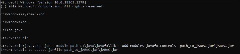

jARec v4 - I have installed jAReC_v4A3 and extracted the files in the java zip file to C:\java and then opened up a CMD box with administrator rights and used the command line you provided but get the following message. Do I need to setup a path command in the environment variables?
My apologies you are correct. The Android displays the available USB Serial Interface 0403:6015 FTDA FT230X Basic UART which works fine.
Hi Chris.
Replace:
path_to_jAReC.jar\...
with your real path to jAReC_v4A3.jar file, like for example:
C:\jAReC\jAReC_v4A3.jar
Replace:
