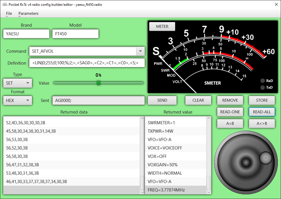

In V4 I've implemented a very comprehensive pRxTx Config file builder, that will help a lot with commands definition and testing, without the need to use Pocket RxTx for that.
This builder is now based on a new simplified syntax for the config file, fully redesigned, that will be used in Pocket RxTx v4. It cannot be used to define and test commands for v3.
In v4, radio feedback is permanent for all parameters that are defined in SET commands, so the sync between PocketRxTx and the radio will be continuous.
I didn't have time yet to work on the updated jAReC v4 user guide, but the new interface is very intuitive (I hope).
Just some hints, for not so obvious features:
- when in builder and PANEL answer format, you can double click on any display field to associate it with a parameter
- in v4 you have 4 type of commands: SET, READ, PAT (pattern) and CAL (calibration)
- for each parameter you have now a single command (not one for each possible value)
- each SET command can have an associated READ and PAT command
- I've included the v4 config for IC7300 and a partially one for XIEGU. Use them as reference. IC7300 v4 config was full tested
- jAReC v4 can copy all the commands of a specific type to the clipboard and then yo can paste then directly in the radio config file, in bulk.

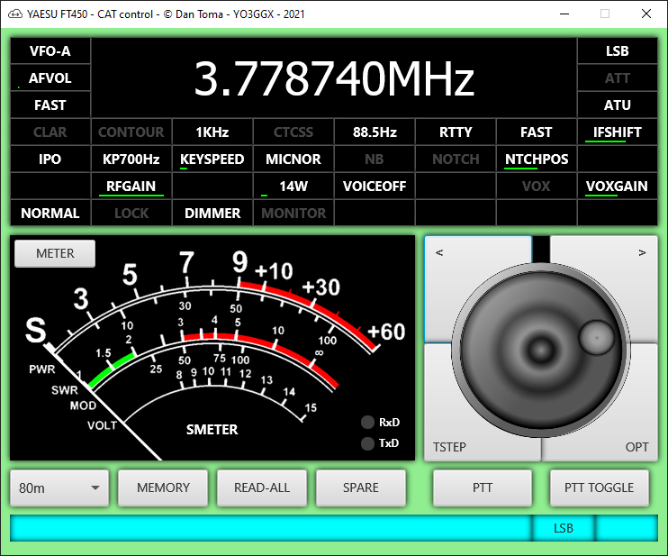

Some sample screenshots from the new GUI.
