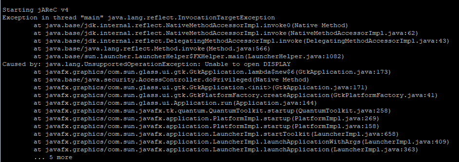

Can jAReC v4 running without DISPLAY on a RaspberryPI ?

Hello.
jAReC v4 can work without a physical display, but does require an X server to run, as is based on javaFX. You can set it up remotely through VNC. There is no console version for v4 and I do not have plans to build one.
