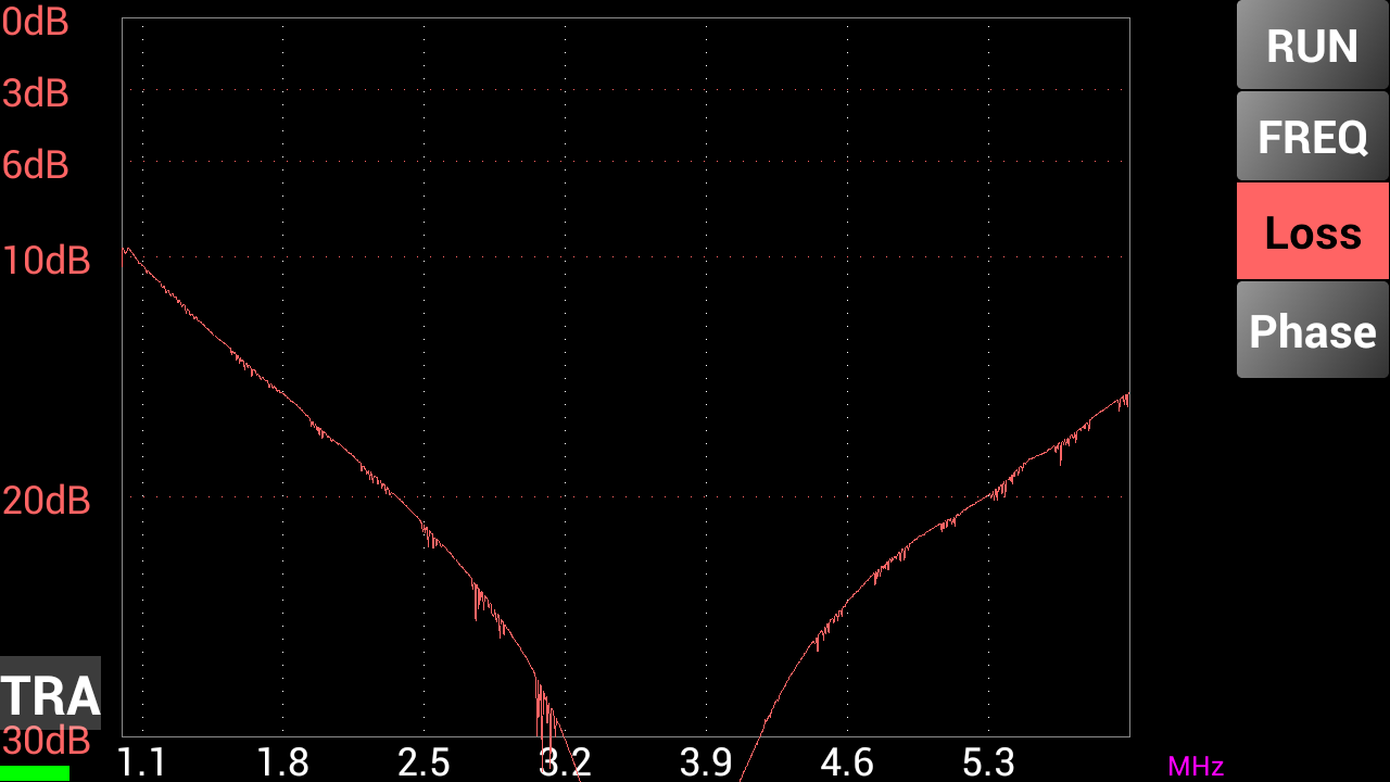

Hi Dan
Here a picture from my Galaxe s3 from the measurement of the LC circuit (80m coax traps) and I can not get it to switch to 60dB scale, but it may well be that the problem is my s3 are the problem.
vy 73
oz7ox
ole

Hi Ole,
Please save the capture to a vec file and send it to me. You can post it in this thread or send it to me by mail.
Maybe in some particular cases the scale does not change automatically to 60dB and I want to check this with your data.
For sure it will be solved.
