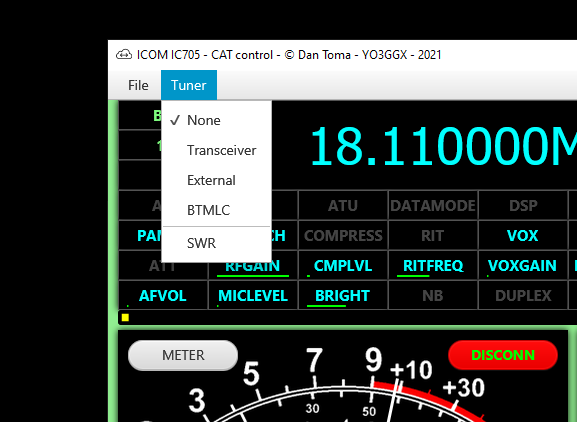

I forgot to mention Tuner functionalities.
- None - no tuner available at all. TUNE button will have no effect
- Transceiver - When TUNE pressed, SET_ATU=TUNE is executed (if defined in the radio config)
- External - While TUNE button is pressed, the radio is set to 1W, mode to AM and PTT to ON. This can help you tune using an external standalone tuner. When released, the radio TXPWR and MODE are set back to previous values.
- BTMLC - This activate the control for my BTMLC tuner (Bluetooth Magnetic Loop Controller tuner). This feature is not fully developed yet, but the hardware was already being presented in a MAGLOOP Facebook group. This allows wireless automatic tuning for any magnetic loop antenna.

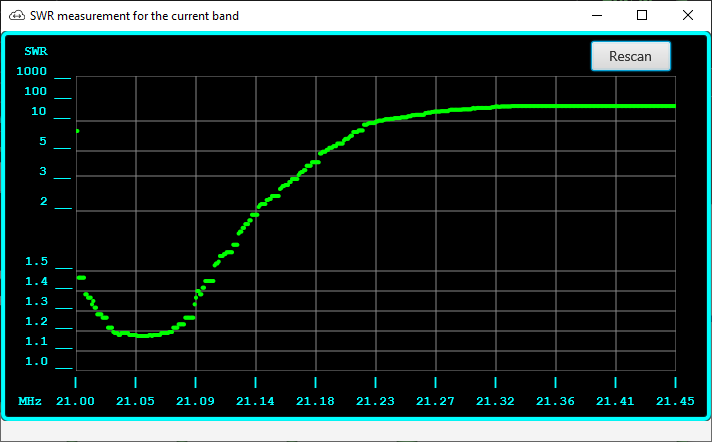

- SWR - The SWR measurement is started for the current band and a graph is displayed. Measurement is performed with 1W and AM.
If you test this feature, I would like to get your feedback.

I am also aware and saw the tuner functionatilies... I have selected "transceiver" option for me as i use the internal tuner of the radio (ft-450) but since my antenna is with swr 1.1 on 4 bands... i never use nowadays.

I have to video links of video screenshots regarding the power meter test and also the test of SWR functionality.
1. Power Meter test (to catch the 0) https://www.iplayradio.net/cdn/files/pu ... r-zero.avi
2. SWR test https://www.iplayradio.net/cdn/files/pu ... -again.avi
